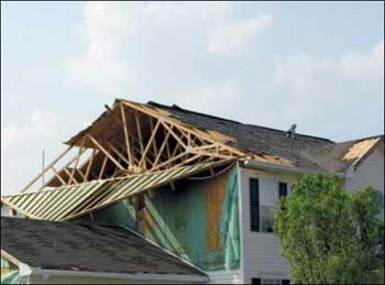

Negative pressure from hurricane-force winds pulled the top of the gable end outward after it ripped off the sheathing at the edge of the roof. The retrofit measures briefly described in this article can dramatically reduce the risk of such an occurrence.
Observations made in the aftermath of Category 3 and stronger hurricanes have clearly illustrated the vulnerability of gable ends. Failure comes in three varieties: The most common gable-end failure is one where the wall loses support along its top edge — typically because the sheathing gets blown off. The second most common failure is at the connection between the triangular gable-end wall and the rectangular wall below it. In this scenario, the wall gets pulled out by the negative pressure of the wind. The third potential failure is collapse of the actual framing members that make up the gable-end wall structure as a result of bending stresses from positive wind pressures. In any case, the damage is usually disastrous to the home and its contents. Not only is the structural damage severe, but a collapse of the gable-end opens the house to wind-driven rain, which can condemn a home to catastrophic damage.
