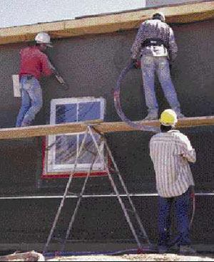

Scratch coat. The first coat serves as the foundation for the next two coats. It should be harder than the brown coat and requires a richer mix — one part cement to two to four parts sand. Webber recommends Type II cement without lime or other additives. “It’s got no body and is hard to spread, but when cured, is super strong,” he says (Figure 3).
FIGURE 3. SCRATCH COAT.The first coat should be the hardest, using a rich mix. Stucco contractor Ron Webber recommends a Type II “plastic” cement without lime or other additives for the scratch coat. The mix will have no body and is hard to spread, but applying it with a pump makes this practical and results in the strongest possible base coat.
Before applying the brown coat, Webber verifies the hardness of the scratch coat by dragging a nail over the wall. If the nail does not dig in but leaves a white line, the stucco is hard enough for the brown coat.
Brown coat. This is a leveling coat that provides the flat surface for the finished wall. The brown coat also adds strength and thickness, and it is in large part what determines the quality of the finish. It’s a little sandier, at one part cement to three to five parts sand. The increased sand helps reduce the number of shrinkage cracks.
Finish coat. This is what provides the final texture and color (Figure 4). Premixed finish-coat materials usually work fine. Webber recommends steering clear of dark colors, especially reds. Dark colors are prone to spottiness and, if not well blended, will not match the color sample.
FIGURE 4. FINISH COAT. Code requires waiting at least seven days before applying a finish coat. Hairline cracks in this color coat are inevitable, but if the base coats are well cured, these surface cracks will not communicate water through the stucco.
Curing. By code, builders should provide at least 48 hours of curing time after the first coat is applied and wait seven days after the second coat before applying the finish. The critical consideration is that the scratch coat must be hard.
Curing schedules, however, prove to be the Achilles’ heel of modern-day stucco. The first and second coats are often installed in the same day to keep the stucco crew on the job site. Except on a handful of custom jobs, it’s rare for the end of the job to wait seven days in a fast-paced construction climate. Such are the realities that push Lstiburek to his hard-lined conclusions.
